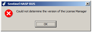

If you get the "Could not determine the version of the License Manager" error (as shown below), it generally means that you have obsolete or non-existent HASP drivers. You can usually resolve it by downloading and installing the latest HASP drivers from here.
