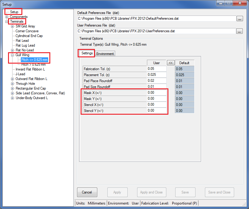

I understand you can do that in Pads. My question is what does PCB Footprint expert do for soldermask and solderpaste when it outputs decals to pads ? Are they the same size as the pad ? What do you mean by swelled soldermask ? Are the soldermask created largerthen the pad size ? If so is this size controllable ?

Post Options Post Options   Thanks (0) Thanks(0)   Quote Tom H Quote  Post ReplyReply Direct Link To This Post Posted: 02 Nov 2012 at 7:32pm
Yes, the user preferences in every "Setup > Preferences > Terminals > Terminal Type > Settings (tab)" -
