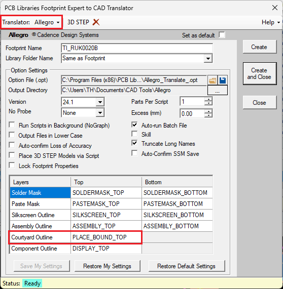

The Component Outline has always been Nominal for the past 25 years.
Everyone uses the Courtyard Outline for the PLACE_BOUND layer in Allegro.
Make the Courtyard Excess 0.00
Courtyard Options - Expand Courtyard to Include Silkscreen > Off
Courtyard Options - Apply Courtyard Excess Option to Pads > Ignore
The Courtyard Excess follows the Maximum Body Dimension (just like you want)
This is what other Cadence users do.

Allegro uses the Courtyard for PLACE_BOUND_TOP.

It's been in the Allegro translator since 2005.
