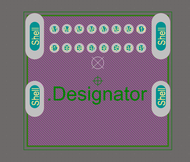

dramos View Drop Down
Joined: 18 Feb 2021
Points: 101
Post Options Post Options   Thanks (0) Thanks(0)   Quote dramos Quote  Post ReplyReply Direct Link To This Post Posted: 24 Nov 2025 at 1:55pm
Hi AGONZ67,
We are using in the next way, the center of the component is the copper center.
In the courtyard mechanical layer we place another center mark that is the center of the rectangle of the courtyard.
Waiting your comments, this is an interesting discussion.
Regards
david

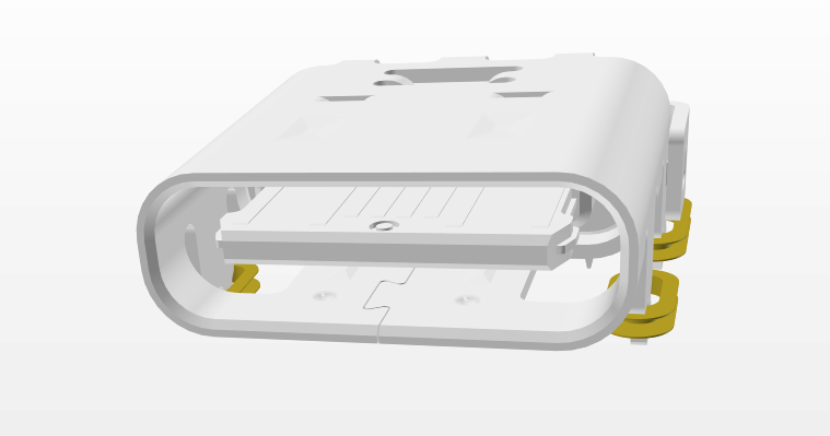

PS: the attached pic are related to 2137160001 Molex connector
