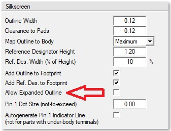

You can turn it on/off in the "Tools > Options > Drafting > Silkscreen".
If it's unchecked there is no expanded silkscreen.

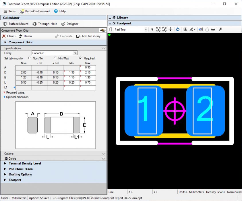

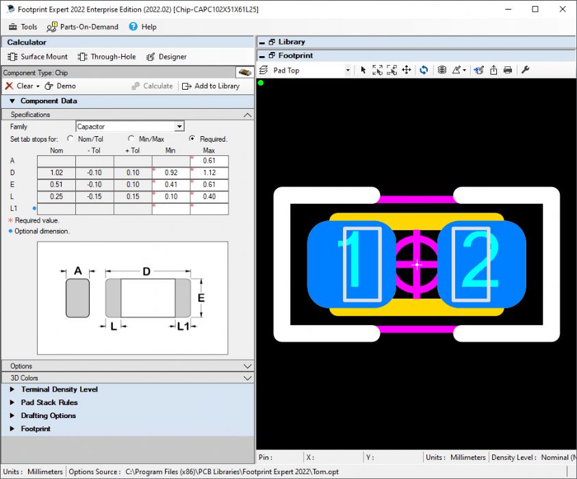

0402 Chip Silkscreen Outline
0805 Chip Silkscreen Outline

Redownload V2022.02 and install the latest version.
