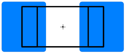

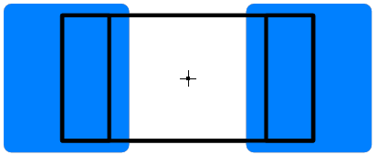

Here is a 0603 Chip with no tolerances:

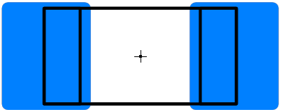

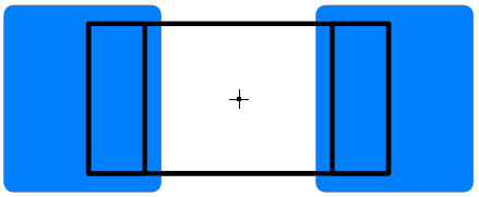

Here is a 0603 Chip with a 0.05 tolerance on Length, Width and Terminal Nominal Density Level:
Here is a 0603 Chip with a 0.10 tolerance on Length, Width and Terminal Nominal Density Level:

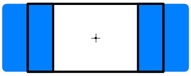

Here is a 0603 Chip with a 0.15 tolerance on Length, Width and Terminal Nominal Density Level:
Here is a 0603 Chip with a 0.20 tolerance on Length, Width and Terminal Nominal Density Level:

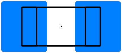

Here is a 0603 Chip with a 0.25 tolerance on Length, Width and Terminal Nominal Density Level:
Here is a 0603 Chip with a 0.10 tolerance on Length, Width and Terminal Least Density Level:

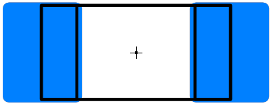

Here is a 0603 Chip with a 0.10 tolerance on Length, Width and Terminal Most Density Level:
