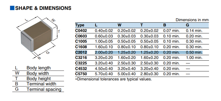

Hi to all,
I want to create a footprint for a TDK capacitor C2012X5R1V226M125AC.
Reading the documentation I realized that the manufacturer does not mark the max and min size of the metallization. Instead of it, we have the value of the min metallization length and min length of the ceramic body of the part.
And here is my question,
would be right to think that the metallization max length is equal to the length max of the part minus the in length of the ceramic body and divided by two?
2.20mm - 0.50mm =1.7mm / 2 = 0.85mm
Therefore, the metallization size would be 0.2mm - 0.85mm
Is normal to find the metallization length in that way (min metallization-min ceramic body)?
Thanks to all for your help.
David

Post Options Post Options   Thanks (0) Thanks(0)   Quote SDTKO Quote  Post ReplyReply Direct Link To This Post Posted: 14 Feb 2023 at 5:21am
That's what I would do as well. Maybe the manufacturer also has a recommended land pattern?
It's a common thing for manufacturers to specify the min. ceramic body length. If you have requirements regarding creepage distances (e. g. medical), this dimension gives you directly what you need to know.

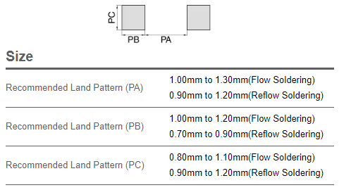

Post Options Post Options   Thanks (0) Thanks(0)   Quote Tom H Quote  Post ReplyReply Direct Link To This Post Posted: 14 Feb 2023 at 9:15am
When the manufacturer does not provide the adequate dimensional data, I always search for the mfr. recommended pattern and then insert dimensions until I come close to that pattern.
https://product.tdk.com/en/search/capacitor/ceramic/mlcc/info?part_no=C2012X5R1V226M125AC

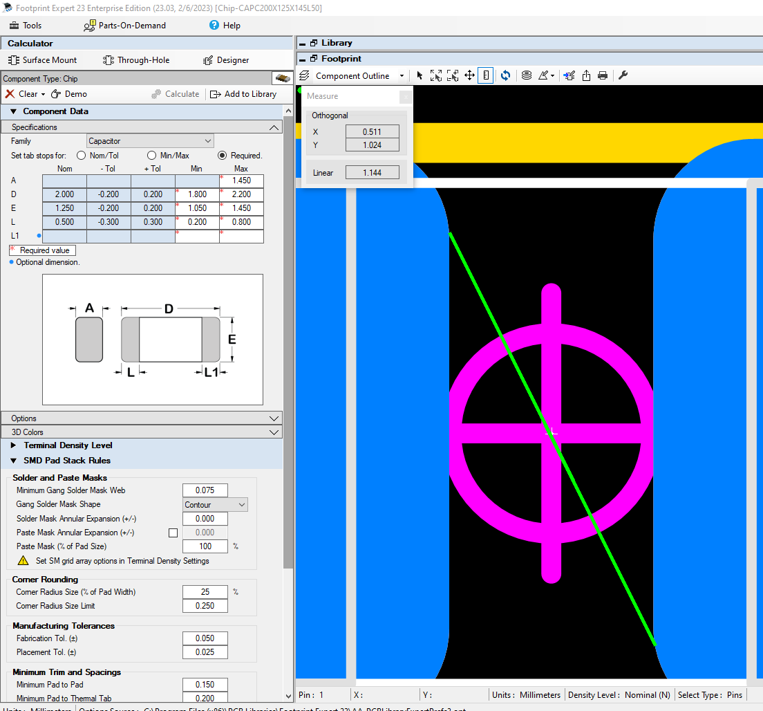

Post Options Post Options   Thanks (0) Thanks(0)   Quote dramos Quote  Post ReplyReply Direct Link To This Post Posted: 16 Feb 2023 at 1:05am
Dear all,
Thanks for your responses. It is always very "illuminating" to know how others deal with this kind of questions.
@Tom H, do you think that in that case is correct to use the recommended land pattern? You always say that we have to distrust the recommended land patterns.
For example the PC value for reflow Soldering is 0.9mm-1.2mm when the nominal value of the width of the component is 1.25mm +/- 0.2mm . It means we could have the width of the land pattern smaller that the width of the component. It doesn't sound good to me.
In other hand,@SDTKO and @Tom H, what do you think to look for the max distance of the metallization taking into account that the Heel value is 0.00 and in the worst case?
In that case the min terminal distance, according with the manufacturer data, is 0.5mm. So "playing" with the Footprint Expert and taking into account that the fabrication and placement tolerances we could get a Max value for the metallization.
Do you think that could be a nice approximation?
In my case, with a Lmax =0.8mm I satisfied the condition.
I configured my fabrication and placement tolerances as 0.50mm and 0.025mm
Please check the attached picture.
Thanks to all for comments.
Regards,
David

Post Options Post Options   Thanks (0) Thanks(0)   Quote SDTKO Quote  Post ReplyReply Direct Link To This Post Posted: 16 Feb 2023 at 1:56am
TDK is a reputable manufacturer and them having recommendations for different soldering techniques indicates that they put in at least some effort to figure out these patterns. Maybe I just do a very brief check whether the pattern dimensions aren't complete garbage, e. g. leaving no or negative toe with max. or even nominal dimensions. That would be enough for me to trust them.
I don't mind the heel being zero or negative at all (which is also reflected by the FPX heel solder joint goals).
When in doubt I always ask the assembler on his opinion on a specific land pattern.
