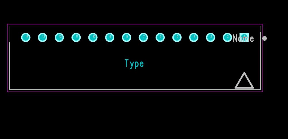

I created SHDRRA14W50P200_100_14X1_2990X760H280. The resulting decal in PADS has silkscreen in multiple overlapping segments. The invisible part is only 0.025 thick, the visible parts (multiple segments) are 0.12 thick and they all overlap.  Here is a screen shot with the assembly layer disabled. Is this expected?

It is the same with 2010.08 and so may be this is expected. I will appreciate if you can help me understand why the silkscreen is not a complete rectangle as one would expect, given the clearances.

Post Options Post Options   Thanks (0) Thanks(0)   Quote Jeff.M Quote  Post ReplyReply Direct Link To This Post Posted: 04 Mar 2017 at 1:45pm
Can you send us an fpx library file containing this part?

Post Options Post Options   Thanks (0) Thanks(0)   Quote jnshah Quote  Post ReplyReply Direct Link To This Post Posted: 04 Mar 2017 at 2:11pm
Sure. Here it is attached.

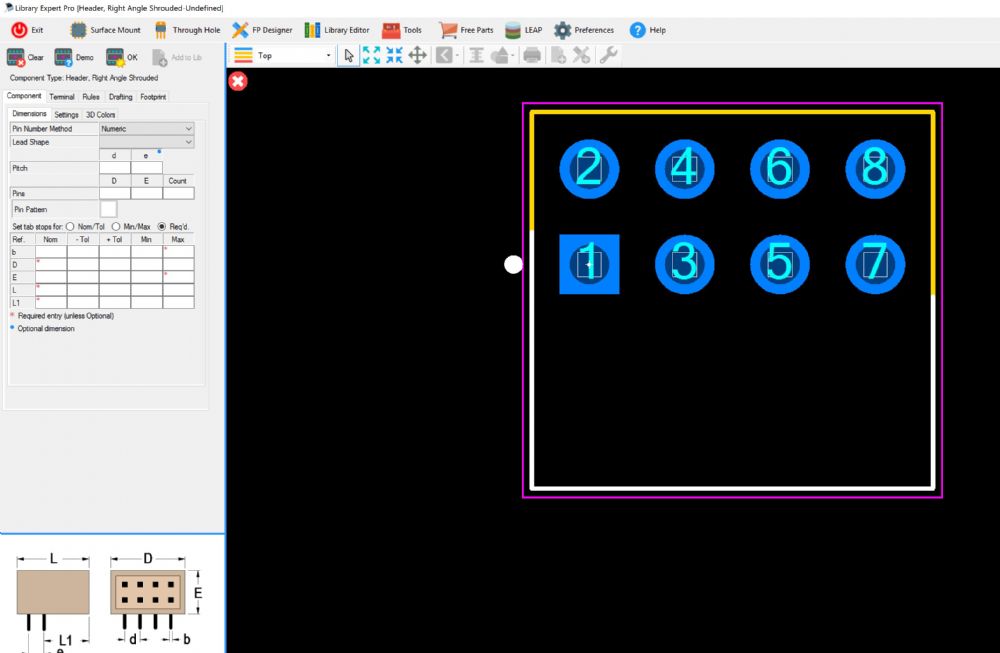

Also, please note that when I create a new part, it shows up as the following with the silkscreen as an incomplete rectangle (This is 2017.08).

Post Options Post Options   Thanks (0) Thanks(0)   Quote Jeff.M Quote  Post ReplyReply Direct Link To This Post Posted: 04 Mar 2017 at 3:08pm
The auto-generated silkscreen outline isn't designed to create a rectangle.

Thank you. Can you please clarify, do you mean it is designed to create an asymmetrical C shape as shown or is it designed to create a rectangular boundary with individual segments?

Post Options Post Options   Thanks (0) Thanks(0)   Quote jnshah Quote  Post ReplyReply Direct Link To This Post Posted: 04 Mar 2017 at 3:49pm
I think I get it. You generate a C shape. As my preferences are set to generate pin 1 line indicator, that makes it asymmetrical.
I need a fully enclosed rectangle. I used the FP designer to create one.
All set. Thank you.
