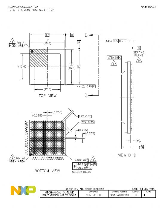

Is it possible to create such non Jedec standard FPGA in Footprint Expert 23 Enterprise
From NXP called H-FC-PBGA-448 17X17X2.46 PKG 0.75mm Pitch

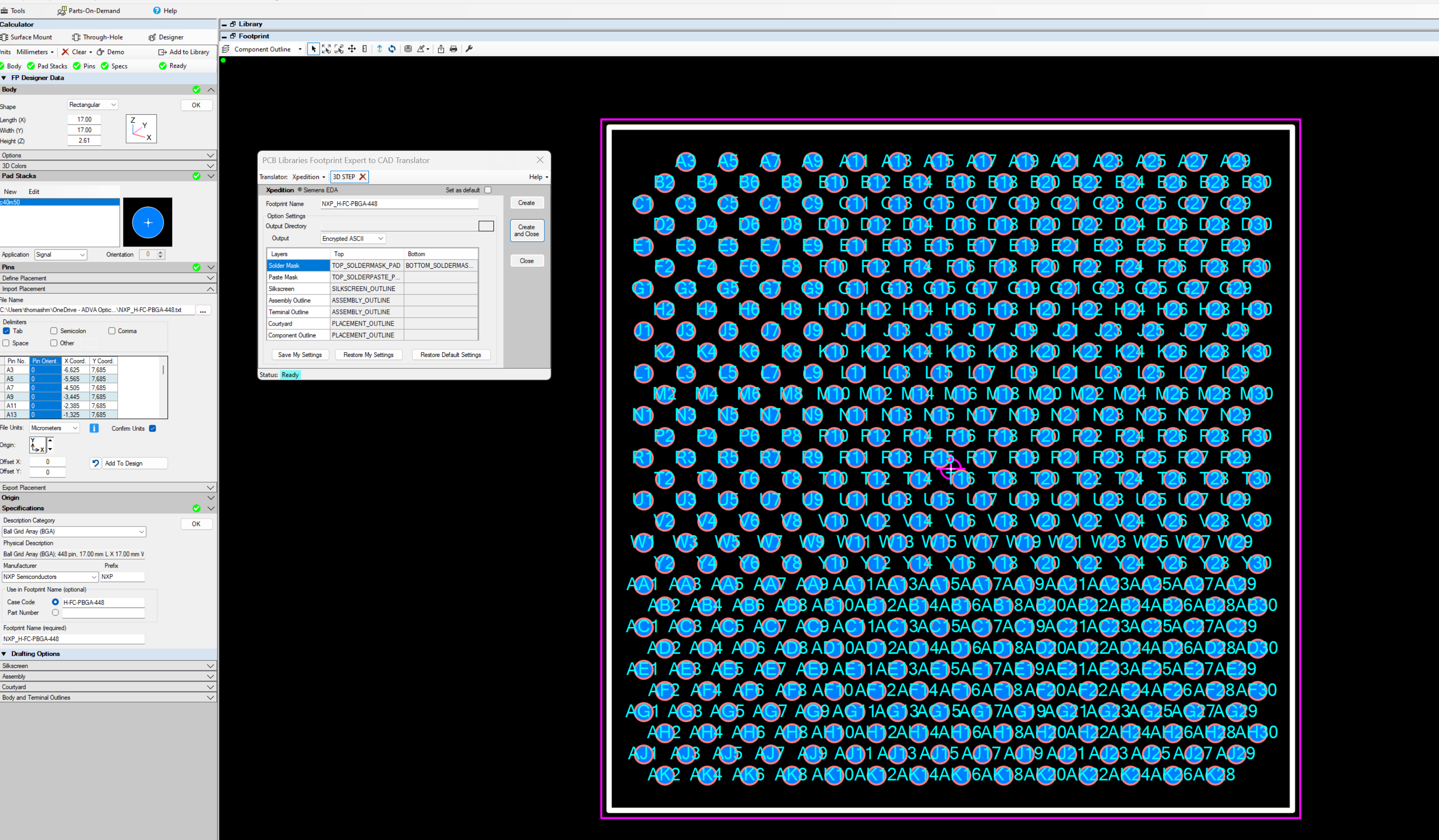

Yes, you can build this non-standard footprint using the FP Designer module and a .CSV coordinate file.
In Excel spreadsheet create column A as the Pin Name, column B as the Pad Rotation, column C as the X coordinate and column D as the Y coordinate.
Then import the .txt ASCII file and it will automatically place all the pins.
For more information on how to do this, contact me and off-line and I will provide instructions.

Perfect Thank You. I created that footprint within some minutes.
What is your recommendation to name such cell in Mentor Graphics we are usually follow the IPC naming convention.
I named it NXP_H-FC-PBGA-448

Yes, the footprint name NXP_H-FC-PBGA-448 is perfect.
The footprint looks great! Good job.
