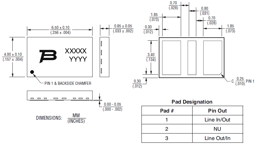

Anybody here having experience with the Bourns TBU-CA High Speed Protectors?
I think the datasheet description of the Pad Layout is a bit unclear.
What Component Category should be used to make the layout?
Thanks

Hi Lars,
The datasheet says its a DFN package:-  However the 3 pins are arranged different than this tool. so I probably would use the 2 pins DFN option and modify it for 3 pins. or just draw it yourself.. not sure if that helps Ouch

This Bourns TBU-CA is a 3-Pin DFN but it's the first one I've ever seen with 3 pins in a row -
We will have to create a new component family template for this part, but in the meantime you can create the library part using the 2-pin DFN and add the middle pin in your CAD tool library editor. I would make the size of the middle pin the same size 0.05 mm annular ring larger than the lead size.
Are there any more of these 3-pin DFN parts out there? We do not like to create component families for unique one-of-a-kind package.

Post Options Post Options   Thanks (0) Thanks(0)   Quote Tom H Quote  Post ReplyReply Direct Link To This Post Posted: 20 Jul 2013 at 12:11pm
These parts are very simple to create in the new "V2013 Footprint Designer" and then save to FPX to share with others on the "Parts on Demand" (POD) website library vending machine.
They should only be built once by someone and then shared with the entire electronics industry.
