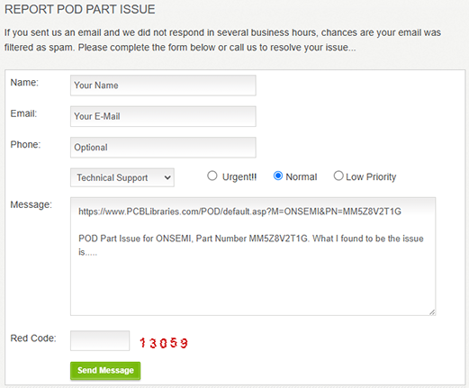

If you find any typos or mistakes, you can report them to PCB Libraries by selecting the 'Report an Issue' in the POD website - www.pcblibraries.com/POD select the manufacturer and enter the part number and select the 'Report Issue' text.
Selecting [Report Issue] will open this page so you can report the problem:
After entering the Message Information select the 'Send Now' button.
PCB Libraries will fix the issue and send you the updated FPX file.
