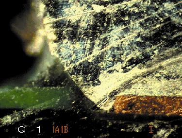

The BGA ball collaspes around the pad edges -
