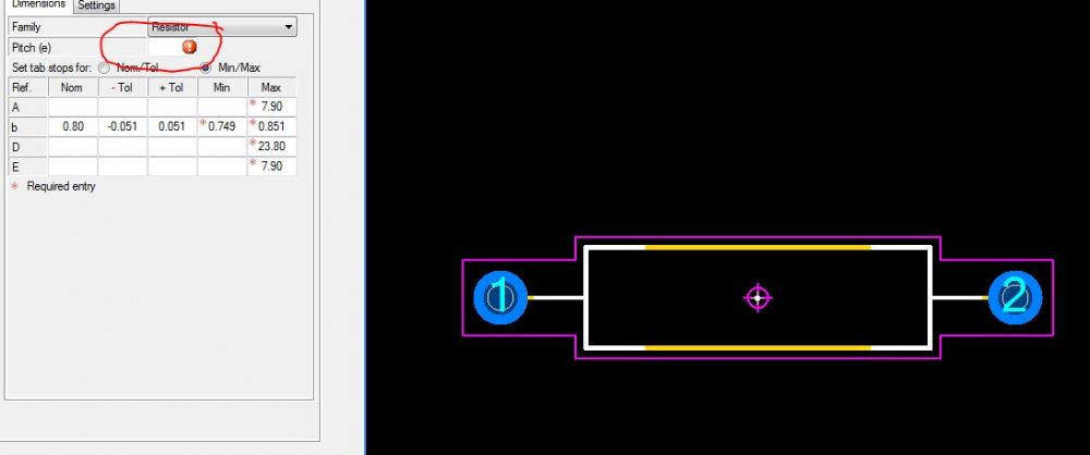

Tom,

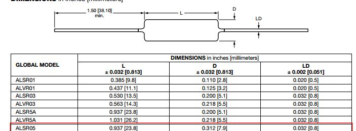

I was using the calculator for an axial resistor footprint.  The datasheet only gives me the length of the leads prior to forming:
The calculator is looking for the Pitch.  How do I determine that?  Couldn't LE determine that based on the inputs?
Post Options Post Options   Thanks (0) Thanks(0)   Quote Tom H Quote  Post ReplyReply Direct Link To This Post Posted: 09 Feb 2015 at 2:58pm
Use the "Utility Tools > Axial Lead Calculator"

Post Options Post Options   Thanks (0) Thanks(0)   Quote BryanT Quote  Post ReplyReply Direct Link To This Post Posted: 09 Feb 2015 at 3:25pm
Ahhhh - great, thanks Tom!
