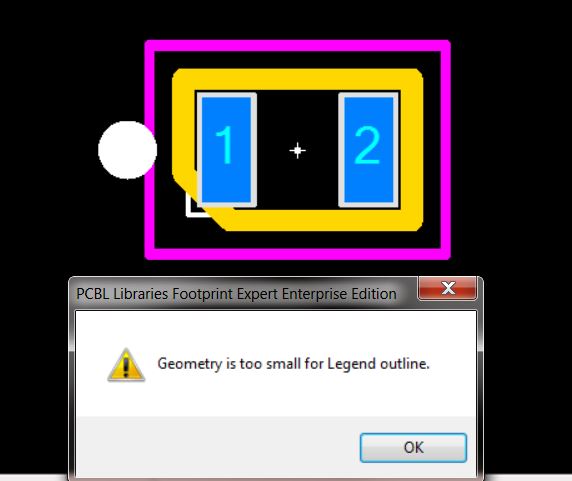

The DFN 2 pin 'Demo' does not create a "Pin 1 Indicator Line", but does create a Pin 1 Dot and a Chamfer outline on the Assembly layer, There is a warning that device is too small for Silk Screen?

The Preferences are filled with rules that you cannot violate. If a rule is violated, certain things happen. Example: You set your Silkscreen Legend Line Width, Clearance and map to Max., Nom. or Min. body in the drafting tab. Then when you create a part that is too small to meet all those rules nothing happens or you get a message "Geometry is too small for Legend outline".
