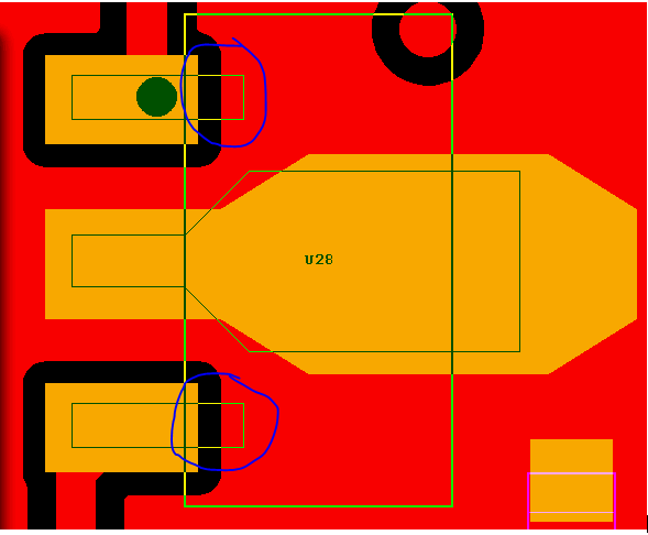

I am curious why all recommended footprints for SOT89 seem to allow the pins to overhang on the inside.  I fear this could cause shorts.
Here is a Valor VPL review of the standard SOT89 footprint. Has anyone else experienced this?
I've also attached a datasheet - uploads/107/Case_style_Dimension_DF782.pdf

The SOT89 was one of the first SMT components invented.
There is no real industry standard so every mfr. makes their own version.
For the Footprint creation I normally add 0.05 mm (2 mils) periphery around the component lead.
I don't understand the datasheet link you provided where the component lead is Q = 0.062" but the mfr. recommended pattern has the pad length 0.059" which is smaller than the lead. So I don't trust the datasheet.
The VPL only matches a specific mfr. part number with a footprint and there are dozens of different part numbers.
You are correct that the footprint in your picture with the VPL lead will short to the copper pour.
We have avoided creating a SOT89 component family for the Library Expert because pin 2 is irregular shaped and comes with many variations. This is one of those parts that you create once and never create it again (hopefully).
