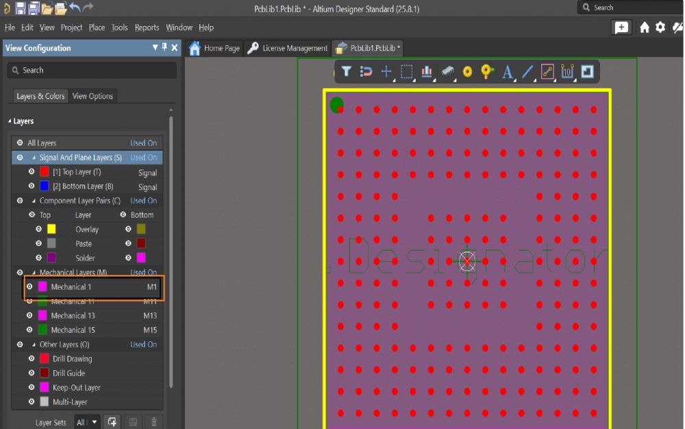

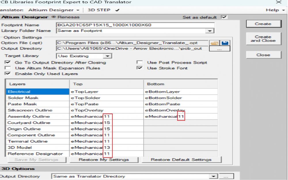

I setup my Altium output for Mechanical Layers 11, 13, 15 only.
However, when open in Altium it appears extra layer Mechanical 1

is this mechanical 1 the Assembly Bottom layer?

Post Options Post Options   Thanks (0) Thanks(0)   Quote Tom H Quote  Post ReplyReply Direct Link To This Post Posted: 04 Nov 2025 at 8:24am
Here are the Altium Default Layer Assignments created in November 2024.
These are the Default Layers in Footprint Expert.
Here is the Altium documentation information to their Style Guide:
In your screenshot, you are assigning Mechanical Layer 11 to the Assembly Outline Top and Bottom. This is not recommended that you use the same layer for both Top and Bottom.
You are also assigning Component Outline, Terminal Outline and Reference Designator to Mechanical Layer 11.
Never seen this before and we don't know any professional Altium user who directs all these elements to the same Mechanical Layer 11.
We highly recommended that you use the Altium Default Layer Recommendations.
Points: 221
Post Options Post Options   Thanks (0) Thanks(0)   Quote m.elsayed Quote  Post ReplyReply Direct Link To This Post Posted: 05 Nov 2025 at 1:00am
Tom,
This is a customized layer option we need.
Mechanical layer 1 appears as blank layer however, we don't need it.
It's in the Script.
Can please check?

Post Options Post Options   Thanks (0) Thanks(0)   Quote Jeff.M Quote  Post ReplyReply Direct Link To This Post Posted: 05 Nov 2025 at 9:32am
The FPE Altium translator only writes mechanical layer 1 to the .pas script when a user assigns Altium eMechanical1 to one of the FPE Footprint layers (like 'courtyard' or 'silkscreen').
Unspecified layers will never appear in a translator script.
If you have a question or issue with layer 1 as applies to your Altium application, then you need to contact Altium.

Post Options Post Options   Thanks (0) Thanks(0)   Quote Tom H Quote  Post ReplyReply Direct Link To This Post Posted: 16 hours 51 minutes ago at 4:26pm
Default Altium Layers. Mechanical Layer 1 = Board Shape

Post Options Post Options   Thanks (0) Thanks(0)   Quote m.elsayed Quote  Post ReplyReply Direct Link To This Post Posted: 8 hours 32 minutes ago at 12:45am
Thanks a lot for your reply, but we need support to solve removing Mechanical Layer 1 from the Footprint Expert output.
Points: 5963
Post Options Post Options   Thanks (0) Thanks(0)   Quote Tom H Quote  Post ReplyReply Direct Link To This Post Posted: 2 hours 20 minutes ago at 6:57am
We can't help you with that. Talk to Altium technical support.
Mechanical Layer 1 is not in the Footprint Expert output script file.
Mechanical Layer 1 is the Board Outline layer.
