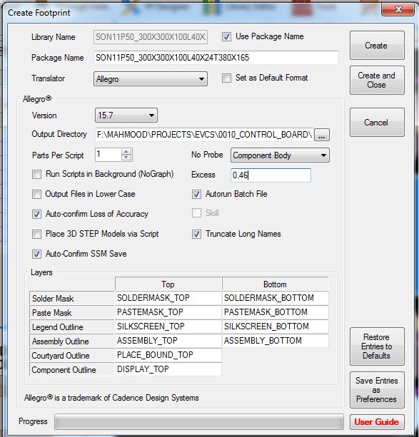

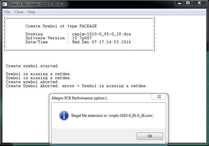

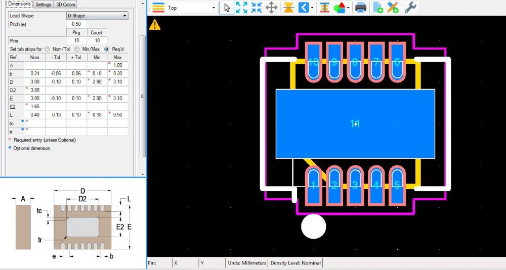

Getting error when creating D shape pad for allegro 15.7
Please check the below images for more info.
                        Allegro output. No pad created

Why would SSM be an illegal file extension? I have no way of testing this as its Allegro 15.7. Being so old, you'll have to do some investigating to find out why. Does it put out basic parts? is there a name size limit to the SSM name?
Is it an option to upgrade to 16.6 or 17.2?
