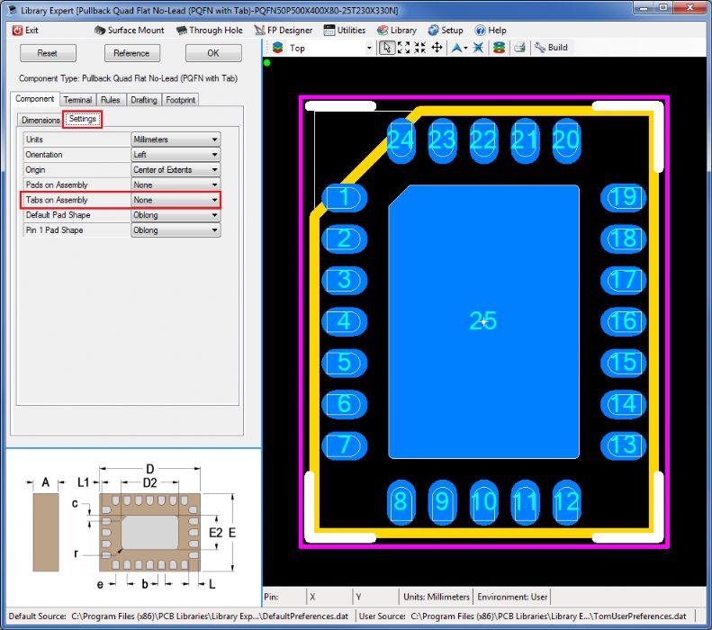

Post Options Post Options   Thanks (0) Thanks(0)   Quote Tom H Quote  Post ReplyReply Direct Link To This Post Posted: 16 Nov 2013 at 8:58am
For all component families that support Thermal Pads, select the "Settings" tab and use the drop-down "Tabs on Assembly".

Post Options Post Options   Thanks (0) Thanks(0)   Quote IanOnBass Quote  Post ReplyReply Direct Link To This Post Posted: 16 Nov 2013 at 1:17pm
Thanks for adding this feature!
I've been using it for a while ;-)
