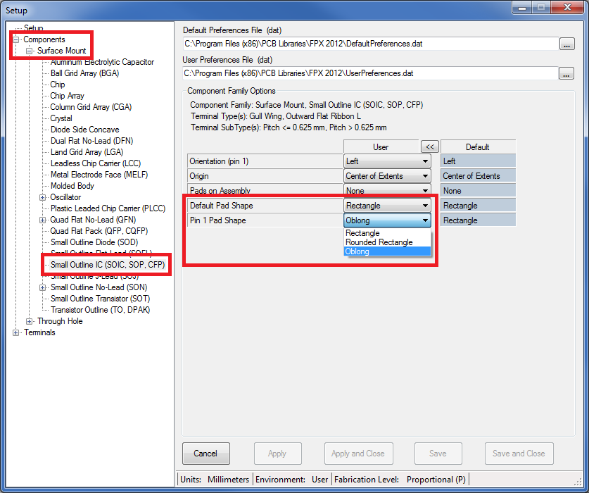

Add the possibility to have pads Rectangular on Pins 1 in the all family.
If your cad support the rounded pad or a user chose to Oblong pads.
So it will be easy see the polarity of the components even is Silkscreen is Not printed on the PCB.
Points: 6032
Post Options Post Options   Thanks (0) Thanks(0)   Quote Tom H Quote  Post ReplyReply Direct Link To This Post Posted: 22 Oct 2012 at 9:18am
You can easily change the pad shape for all pins and have a different shape for Pin 1 to show polarity when there is no silkscreen outline.
Open "User Preferences > Components > Surface Mount > SOIC > Pin 1 Pad Shape"
