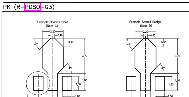

Pin 2 with Chamfered Leads on two ends:

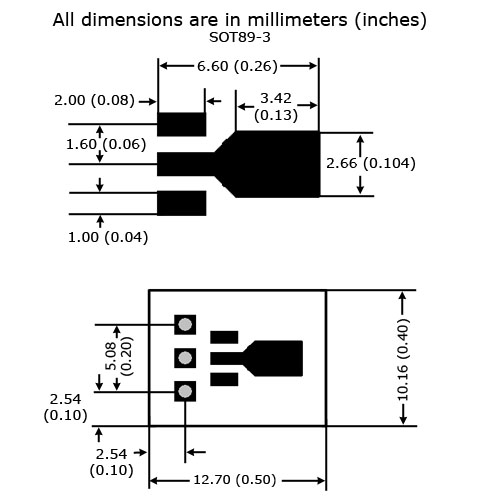

SOT89 with 5 leads:

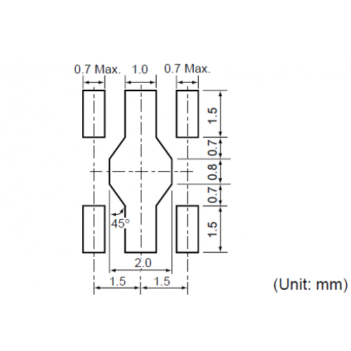

SOT89-5 with unique Pin 2:

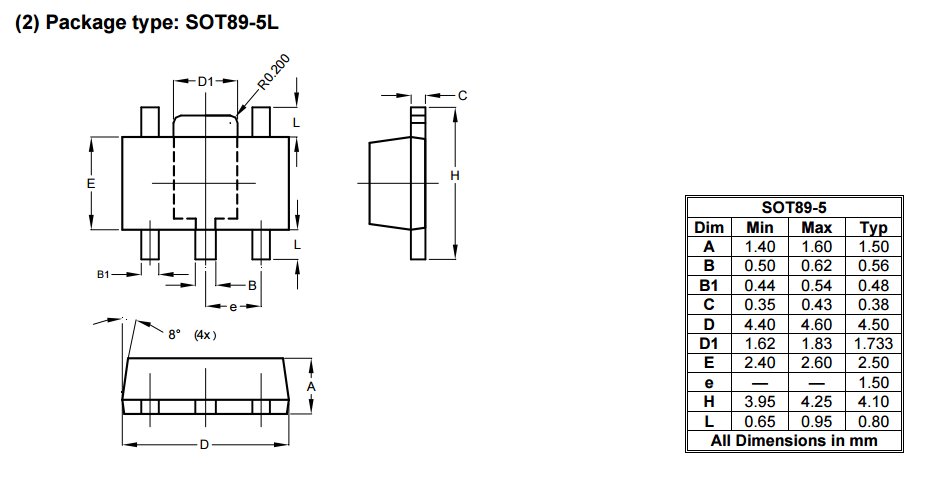

 SOT89 with chamfered Pin 2 on one end and rectangle on the other end:
