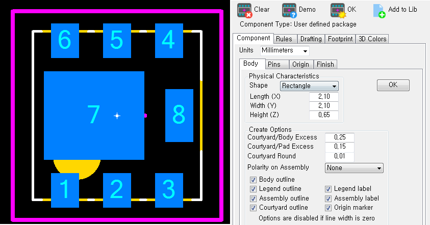

I set up the prefernces to big the solder mask in the Library expert.
But When I downloaded the FPX file in the POD, I founded solder mask oversize is missing.
FPX file has two type. one type is made in the suface mount menu.
two type is made in the FP designer.
It seems to be a file made of the FP designer.
Why doesn't it make the solder mask oversize?
Post Options Post Options   Thanks (0) Thanks(0)   Quote Tom H Quote  Post ReplyReply Direct Link To This Post Posted: 07 Sep 2017 at 8:18am
Preferences for Solder Mask only apply to "Standard" Calculator parts.
You can fully edit the solder mask swell in FP Designer by using the "Edit Pad Stack" button in the toolbar which opens the "Pad Stack Manager".
Then select the Solder Mask layer for each pad stack and change the value to whatever you want.
Then re-save the part to your FPX file by selecting the FINISH tab and OK > Add to Lib buttons.
Make sure that the entire row in the FPX file is highlighted so that you update that entry and not add a new Row.
