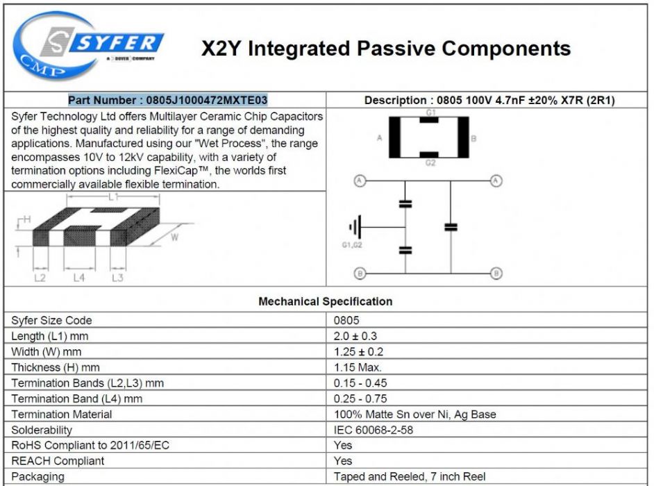

Hi All,
I have a slightly unusual package, which I can't find in the PCB Expert software to generate, I could do this manually of course, but I would rather keep everything IPC if possible.
Can somebody recommend how I do this in the PCB Footprint Expert? Cheers Tongue

The Footprint Designer option in the Library Expert can do build this part.
For an example on how to use it:
http://www.pcblibraries.com/products/fpx/userguide/default.asp?ch=108
Points: 1977
Post Options Post Options   Thanks (1) Thanks(1)   Quote Nick B Quote  Post ReplyReply Direct Link To This Post Posted: 06 Dec 2013 at 11:15am
You will need to use the manufacturer recommended footprint (not part of the screenshot above), but I searched online for the spec sheet for 0805J1000472MXTE03 and it is provided.
