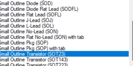

Post Options Post Options   Thanks (0) Thanks(0)   Quote m.elsayed Quote  Post ReplyReply Direct Link To This Post Posted: 24 Sep 2025 at 2:12am
Please provide more details for this note "Some 3D models may not support the polarity dot"
it added for all the packages below
it will be great if have document explains this point so i can be aware by this concept

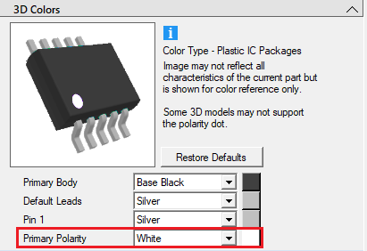

Post Options Post Options   Thanks (0) Thanks(0)   Quote m.elsayed Quote  Post ReplyReply Direct Link To This Post Posted: 24 Sep 2025 at 2:27am
also
Points: 5915
Post Options Post Options   Thanks (0) Thanks(0)   Quote Tom H Quote  Post ReplyReply Direct Link To This Post Posted: 24 Sep 2025 at 8:14am
If the 3D Color panel in the Calculator has 'Primary Polarity' then the 3D STEP model will have polarity. If there is no 'Primary Polarity' button then there is no polarity dot.
