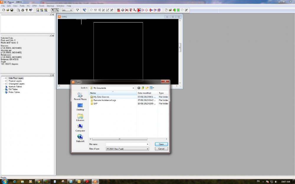

Post Options Post Options   Thanks (0) Thanks(0)   Quote sgdavies Quote  Post ReplyReply Direct Link To This Post Posted: 26 Sep 2012 at 1:12am
HI Matty, Just checking my latest install of GC Preview, seems like they already support  IPC2581 Big smile
UPDATE...
I downloaded testcase 1 from the IPC website
But GC Preview wouldn't open the file, so I downloaded the Free Vu2581 viewer and seems to work ok, but differently from GC Preview.
