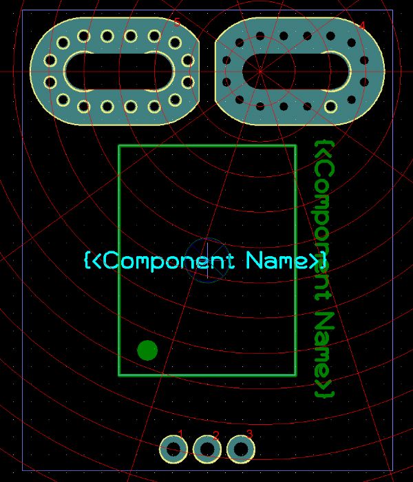

Hi Guys and Gals,
I have been creating a footprint with my Allegro CAD software, which involved me having to create shapes for the pads and also use via stitching to keep them cool (see photo attached) what i am wondering is, does the new FP Designer have this capability yet?

Not an ALLEGRO_ACS754xCB-150 by any chance?  I created a footprint just like this for a Pulsonix using collegue a few years ago which I'm happy to share with other Pulsonix users.  I uploaded it to the Pulsonix User Group at the time so it's still there.  I can't output it in anything other then Gerber for other CAD users though.
I used radial grids to do the via rings on the slotted oval pads.
