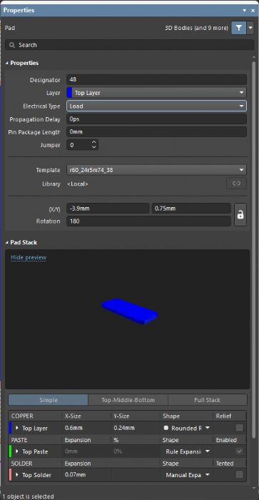

Through-hole Solder & Paste Mask Pad Stack Issue
Points: 5940
Post Options Post Options   Thanks (0) Thanks(0)   Quote Tom H Quote  Post ReplyReply Direct Link To This Post Posted: 12 hours 26 minutes ago at 8:35am
Solder Mask Expansion is set in Altium Preferences.
In Altium go to 'Preferences > PCB Editor > Defaults > Pad > SOLDER Expansion > 0.00'
Then the solder mask expansion will be 1:1 scale.
