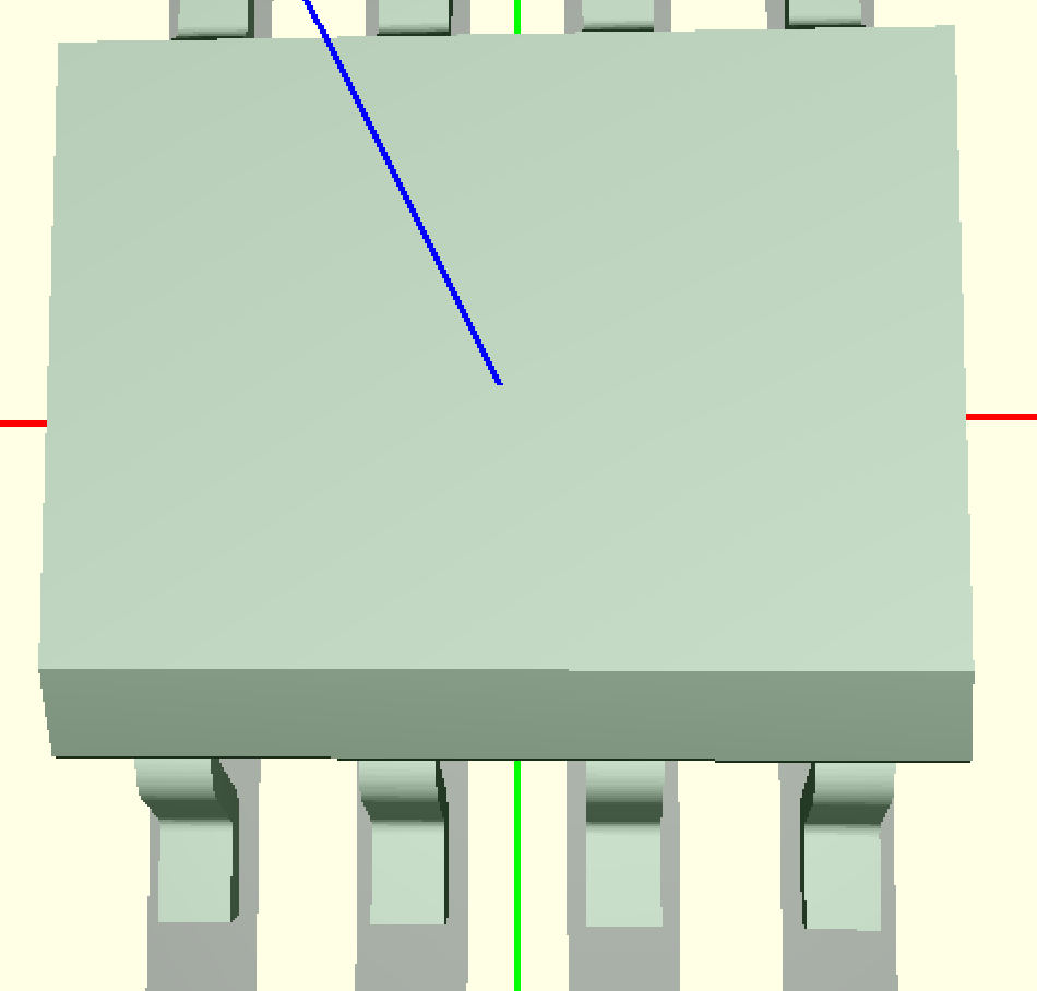

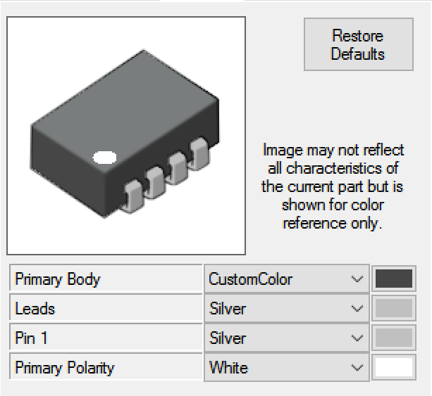

How can I configure a Pin 1 dot instead of a Pin 1 chamfer for the 3D Step export?
Sample pictures and sample library attached.
Picture of pin 1 as expected:
Picture of pin 1 as exported with chamfer:
Points: 6070
Post Options Post Options   Thanks (0) Thanks(0)   Quote Tom H Quote  Post ReplyReply Direct Link To This Post Posted: 04 Jan 2017 at 3:00pm
SOIC's with a 0.05" (1.27 mm) pin pitch do not have a Pin 1 dot on the physical package.
Only metric pin pitch parts have a Pin 1 Dot.
You can color the Pin 1 3D Model Lead to a different color, but you cannot change 3D Model images in Library Expert.

I have some parts with a pitch >= 1.27mm with a pin 1 dot.
For these parts I can easily change the exported 3D step model before I integrate it into the layout library.
