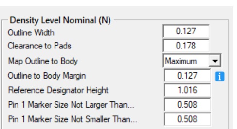

If I make the 'Clearance to Pad' 0.178 as image below what impacts?
Also 'Outline to Body Margin' what this parameter do?

You can't use both Clearance to Pad and Outline to Body Margin at the same time.
It's one or the other.
There is a 'Map Outline to Body' to dropdown menu selection with these Options:
  • None
  • Minimum
  • Nominal
  • Maximum
  • +Margin (select this to turn on Outline to Body Margin)
When you select +Margin, then the Outline to Body Margin value is applied.

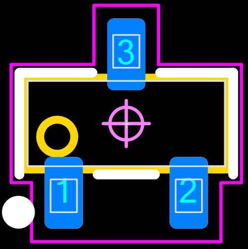

Here is a Silkscreen Outline mapping to the Maximum Body dimension:

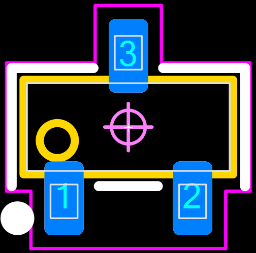

Here is a Silkscreen Outline using the Map to Margin with a 0.15 setting:
Map Silkscreen to Margin allows you too set a distance value for the Nominal Package Body to the Silkscreen. You determine the offset margin.

Post Options Post Options   Thanks (0) Thanks(0)   Quote m.elsayed Quote  Post ReplyReply Direct Link To This Post Posted: 12 hours 25 minutes ago at 1:15am
so please cofrim
1- we should use clearance to pad than margin option, beacuse  clearance to pad set
·       Silkscreen to Pad
·       Silkscreen to Silkscreen
·       Polarity Dot to Pad
2-when use vlaue =0.178, should i change any option also?
3- as images shows oultine width =0.127, and clearance 0.178 , should i change any thing or it ok?
Points: 5954
Post Options Post Options   Thanks (0) Thanks(0)   Quote Tom H Quote  Post ReplyReply Direct Link To This Post Posted: 5 hours 25 minutes ago at 8:15am
Silkscreen to Pad, Silkscreen to Silkscreen and Silkscreen Polarity Dot to Pad are all set by the 'Clearance to Pads' option.
The 'Map Outline to Body Margin' option is Silkscreen Outline to Nominal Package Body.
