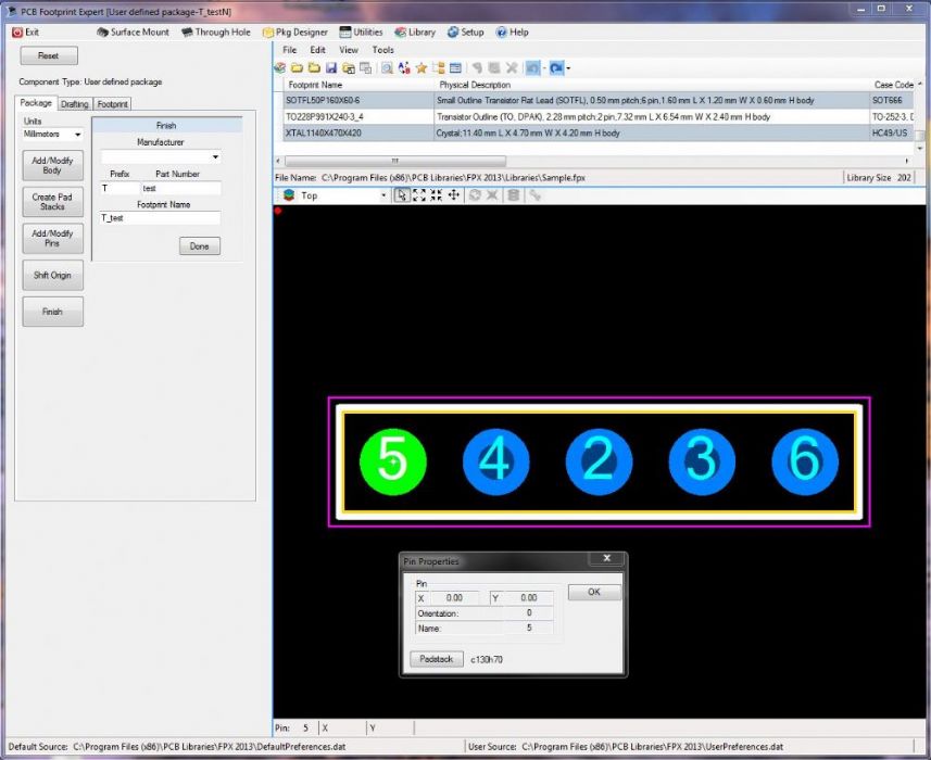

Would be nice if I could renumber pins at will? or am i approaching this totally wrong? i would have expected the pin properties to be editable, at least for the pin name, so I could re-number.

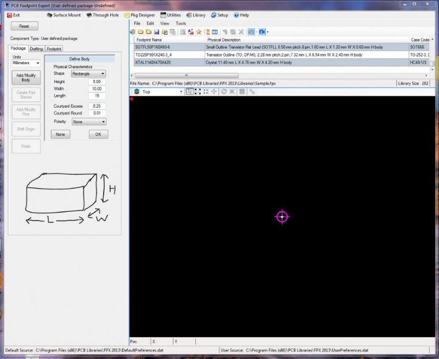

Another one, I know its Elementary Dear Watson, but it seems strange to me that the GUI, For Height, Length, and Width is not backed up with a graphic, Just like all your package types.

I made it so easy (I thought) to add pins with automatic ordering I didn't think renumbering would be an issue.  But if it is I'll revisit the subject.
I like your graphic suggestion, thanks.
