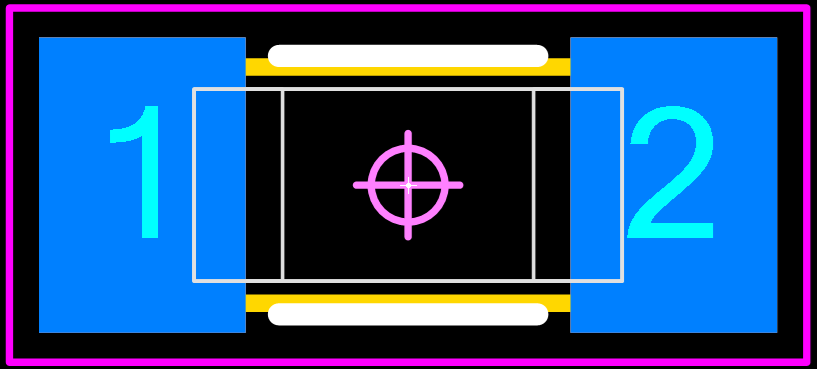

This is obviously missing the six critical drafting outlines. Traditionally, these have been manually created with a plethora of inconsistent rules that get adjusted over time:
  1. Silkscreen
  2. Assembly
  3. Courtyard
  4. Origin
  5. Component
  6. Terminals

  1. The Component Outline is crucial for accurate assembly placement and helps ensure your components fit properly on the board. It helps with verification during visual inspections, and facilitates repair, rework, and future updates to the design.
  2. The Terminal Outlines are likewise critically important. They represent where on the metal terminal leads the physical package makes contact to the PCB. These are essential for reliable soldering and proper electrical connectivity. Each terminal lead outline must be entirely located on a pad. If the pad is not 100% on a metalized terminal outline, then the manufacturer’s recommended pattern is not good, and you will get a bad solder connection.
  3. The Silkscreen Outline enables proper component orientation and should be created so that it’s visible after assembly. Silkscreen outlines should not be placed under the package body – they are useless there and could potentially lift low profile or micro-miniature components off the PCB surface resulting in poor solder joints. The silkscreen data includes a post assembly inspection dot located by Pin 1, which helps with final assembly inspection.
  4. The Assembly Outline is a closed polygon. A chamfered corner is located by Pin 1 if the component is polarized or cannot be inverted during assembly. The assembly outline is important because it provides clear reference points for automated pick-and-place machines. A well-defined Assembly Outline also facilitates design verification and quality control.
  5. The Courtyard Outline is extremely important in defining the required minimum clearance area required for a component, ensuring there is no interference with neighboring components during assembly or operation. The ideal shape is contoured around the package body and pads, which is the default setting in the Footprint Expert. The courtyard excess value for Package Body and Pads can be set separately.
  6. The Origin Outlines are placed on an independent layer. The size & outline width are user definable. Accuracy is essential for accurate alignment because it serves as a reference for positioning the component on the PCB. A precise origin simplifies machine programming and enhances design portability across tools.

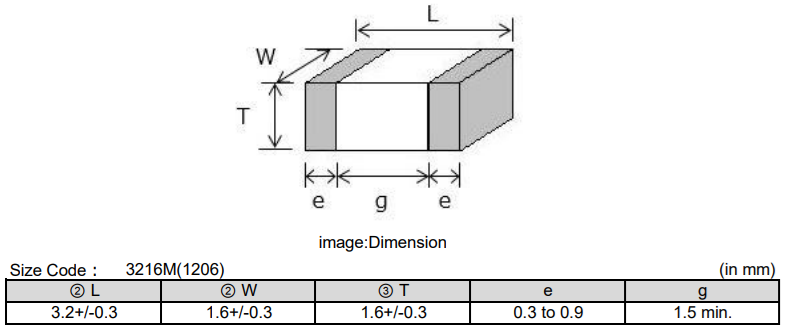

Here is an example of a 1206 capacitor from Murata.
Part Number: GRM31CC72A475KE11L
Case Code: GRM31C
Here are the package dimensions. every value has a 0.30 mm tolerance.

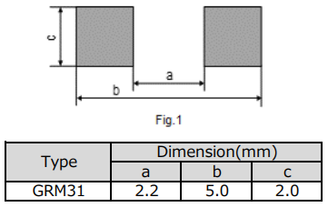

Here is the manufacturer recommended footprint:

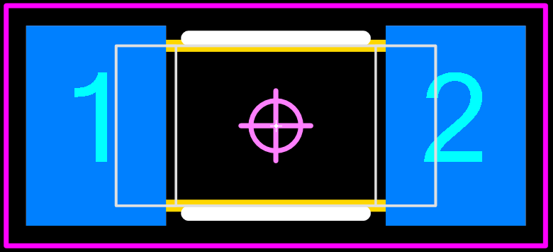

Here is the footprint using Nominal Package dimensions and the mfr. pattern. Notice the terminals are off the pad stack. No Heel.

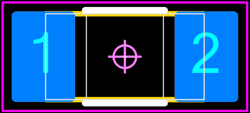

Here is the minimum package material condition according to the tolerances and the mfr. recommended pattern. The terminals are way off the pad stack. No Heel.
Here is the maximum package material condition according to the tolerances and the mfr. recommended pattern. No Heel and minimum Side fillet.
The mfr. recommended pattern does is not compatible when the component package comes in minimum, nominal or maximum material condition.

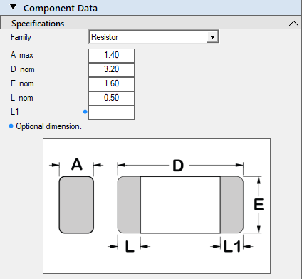

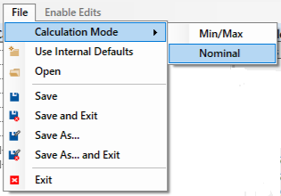

We're not against using the manufacturer recommended patterns, but if you do use them we highly recommended using the Footprint Expert 'Nominal Calculation Mode'.
Using the mfr. recommended pattern completely ignores the component package and terminal tolerances in the IPC-7352 mathematical model. Mfr. patterns ignore all tolerances, so there's no use in spending time inserting them into a footprint Calculator.
To turn on the Nominal Calculation Mode in Footprint Expert, select 'Tools > Options > File > Calculation Mode > Nominal'.
This feature turns off all tolerances in the component family Calculators to greatly simplify the data entry.
The Nominal Calculator has preset solder joint goals that have a fixed Toe, Heel and Side value. All solder joint goal values are editable for you to customize to meet your assembly shop guidelines for maximum quality in assembly attachment.
The IPC J-STD-001 standard was used to derive the Footprint Expert Nominal Calculation Mode solder joint goals. You can use the mfr. recommended pattern or the internal solder joint goals.
However, if you rely on component manufacturer tolerances and do not use the mfr. recommended patterns, we recommended that you use the IPC min/max mode for all your footprint and pad stack calculations. Just be aware that most package tolerances are not realistic. You need to understand which tolerances are too robust and tome them down to more realistic values.
Note: if you use the Nominal Calculation Mode and save the data to an FPX Library, if you switch back to min/max calculation mode, the values saved to FPX will open in the calculator as nominal dimensions (without tolerances).
If you open a min/max footprint from an FPX file library in the Nominal Calculation Mode, the tolerances will be removed and only the nominal package dimensions will display.
