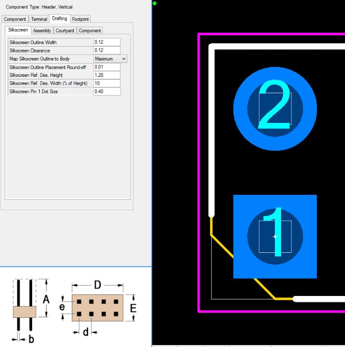

I have reported an issue with silkscreen outline being drawn incorrectly some time ago and Tom has reported back that this bug was fixed. I have downloaded the latest version (2015.10) and I see that it is not fixed.

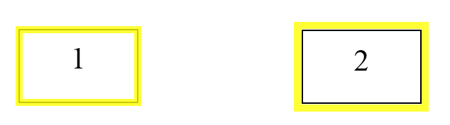

Your tool is doing as shown in the first picture, while it should do as shown in the second picture. You can try it with Vertical Header or just about any other THD part.

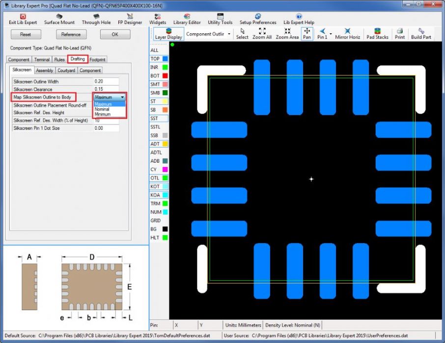

The silkscreen boundary can map to the Minimum, Nominal or Maximum component outline.
The system default is the Maximum component outline but the user can change it to whatever they want in Default Preferences > Drafting > Silkscreen > Map Silkscreen Outline to Body.
The Yellow line represents the Maximum component outline. The Green outline represents the Nominal component outline. The White outlines represent the Maximum component outline and as you can see the inside border of the silkscreen maps to the Maximum Outline. The silkscreen outline is 100% outside the Maximum component body size.

Tom, you are trying it with SMD components. I have suggested using THD parts, for example, Vertical Header. If you try it, you will see that the following will not be the case - "inside border of the silkscreen maps to the Maximum Outline".
