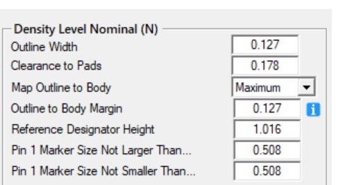

If I make the 'Clearance to Pad' 0.178 as image below what impacts?
Also 'Outline to Body Margin' what this parameter do?

You can't use both Clearance to Pad and Outline to Body Margin at the same time.
It's one or the other.
There is a 'Map Outline to Body' to dropdown menu selection with these Options:
  • None
  • Minimum
  • Nominal
  • Maximum
  • +Margin (select this to turn on Outline to Body Margin)
When you select +Margin, then the Outline to Body Margin value is applied.
