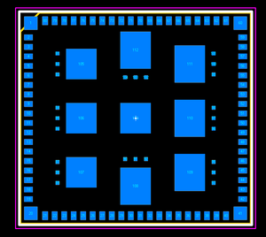

I'm making a footprint for the nRF9151 with FP Calculator. There seems to be some calculation issue with the silkscreen clearance.
This is the silkscreen with 0.200 mm offset:
Clearance 0.200mm

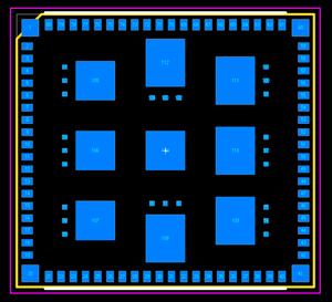

This is with 0.199 mm offset.
The pins are 0.20 mm from the component edges.
Why silkscreen is removed from left and right edges with default settings?
