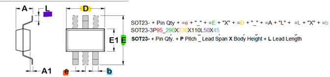

 Pcblibraries naming conventions :
For the first line of the table 1, there are three multi-source parts. This means that these three footprints must be exactly the same. Many companies use multi-source components to manage the supply chain without issues during the assembly process.
Manufacturer
Footprint pcblibraries
Nexperia
SOT23-3P95_290X230X110L30X43 ?? (NEXPERIA_TO-236AB)
SOT23-3P95_290X230X110L50X45 ?? (NEXPERIA_SOT23)

Note: On PCBLibraries.com component from Nexperia seems to have NEXPERIA_SOT23 Casecode instead of TO-236AB (except TL431A) ? Why Nexperia doesn’t have a generic footprint name like SOT23-3P95_290X230X110L30X43 ?Ouch
Question is : All of they footprint are compatible for assembly ? Only one footprint can be created with the worst case dimension? There is a difference about the pitch with “diodes” footprint with 40µm less. Angry
One difference is the length and height of the body which have an influence only in the 3D body (we used max 3D body with additional margin, so not a big issues)Tongue
It should be very interesting for us (and other companies?) to link these footprints and maybe to add some acceptable tolerance (+/-100µm ? or 5% for some criteria) to check the compatibilities in order to generate only one footprint if possible.
