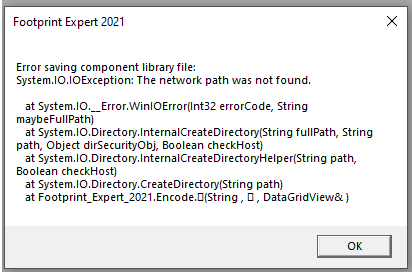

This just started happening recently. I suppose it's something on my end but I don't know how to fix it. Whenever I open an FPX file now and then try to save it I get the following error:
I checked and the file is not read only.
Version 2021.21.
Thank you,
Chris

Nevermind... I figured it out. It was may backup path that was not accessible. My NAS is presently down. I redirected the backup somewhere local and it works now.
Chris
