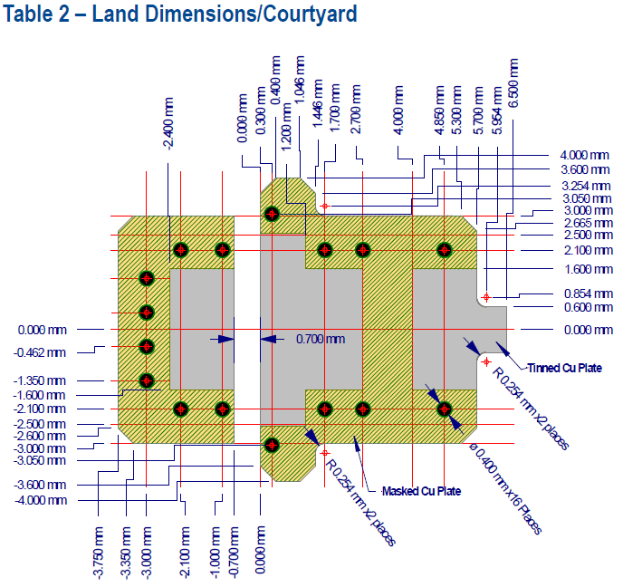

We need the land patterns to be non-symmetrical for a polar capacitor.
Cathode plate is larger to allow greater heat dissipation, and polar mounting.

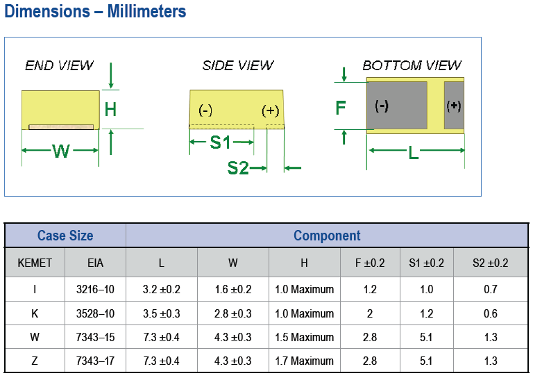

Here's a link to the T528 Low ESL. Facedown Tantalum Polymer Capacitors.
http://www.kemet.com/kemet/web/homepage/kechome.nsf/file/KEM_T2018_T528.pdf/$file/KEM_T2018_T528.pdf
The terminal dimensions are on page 4.  The pad dimensions on page 7 are for the W and Z case, to allow a low ESL connection to the PCB and to allow connection to competitor's three-terminal device. The competitor created a three-terminal device, but there are two cathode connections.  The cathode connection is broken into two to eliminate huge disparities in solder pod areas that could cause the larger cathode plate to lift chip and break anode pad connection.  On our 7343 device we have only two terminals, anode and larger cathode, but recommend using two solder pads for the cathode to eliminate the propensity to lift.  We do not believe that three solder pads are necessary for the smaller case devices.

You're correct that if you just want to use the Kemet Capacitor you do not need 3 pads.
And this land pattern is "over the top" detailed.
You can create a good Footprint using the "Molded Body" component family and then select the "Footprint" tab to enter the mfr. pad sizes and spacing.
I think the center pad "wings" are for the alternate part.
