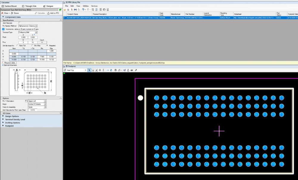

According to this FPX file:
According to below image we build BGA, BUT RESULT CAN'T MATCH REQUIRED data in datasheet.
Please check and let me know your thoughts.

When building these BGA footprints, enter all the pins 1 - 9.
Then window in on the 3 rows (Rows 4 - 6) and Right Mouse Button and select Hide.

Post Options Post Options   Thanks (0) Thanks(0)   Quote m.elsayed Quote  Post ReplyReply Direct Link To This Post Posted: 23 Sep 2025 at 12:34pm
Already did that as image shown
Please check the FPX file , and let me know how to make pin numbering and pin1 orientation as found on datasheet

Post Options Post Options   Thanks (0) Thanks(0)   Quote m.elsayed Quote  Post ReplyReply Direct Link To This Post Posted: 23 Sep 2025 at 12:54pm
i try use all pin orientation option to reach shape on datasheet, but can't
please explain how can achieve shape on datasheet

Post Options Post Options   Thanks (0) Thanks(0)   Quote Tom H Quote  Post ReplyReply Direct Link To This Post Posted: 23 Sep 2025 at 1:50pm
The links to your Data do not work.
The Pin Qty Must Be 16 X 9
Then click and drag a window on the 3 middle rows to select the pins and then -
Right Mouse Button > Hide
This is a very common BGA in 3 minutes that we build regularly with no problems.

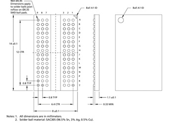

Post Options Post Options   Thanks (0) Thanks(0)   Quote m.elsayed Quote  Post ReplyReply Direct Link To This Post Posted: 23 Sep 2025 at 3:44pm
when use 16*9 not result ball names and number like datasheet
since fpx not work with you below are details, how to bulid this shape like datasheet and pin1 be in upper left
part:
MT41K128M16JT-125:K
datasheet:
