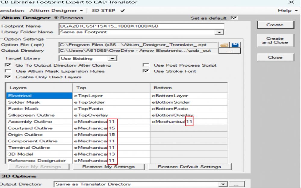

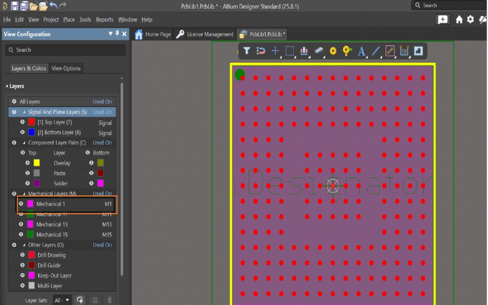

I setup my Altium output for Mechanical Layers 11, 13, 15 only.
However, when open in Altium it appears extra layer Mechanical 1

Really interesting issue. We configure our mech stack in PCBFootprint Expert as well...
is this mechanical 1 the Assembly Bottom layer?

In your screenshot, you are assigning Mechanical Layer 11 to the Assembly Outline Top and Bottom. This is not recommended that you use the same layer for both Top and Bottom.
You are also assigning Component Outline, Terminal Outline and Reference Designator to Mechanical Layer 11.
Never seen this before and we don't know any professional Altium user who directs all these elements to the same Mechanical Layer 11.
We highly recommended that you use the Altium Default Layer Recommendations.

Post Options Post Options   Thanks (0) Thanks(0)   Quote m.elsayed Quote  Post ReplyReply Direct Link To This Post Posted: 05 Nov 2025 at 1:00am
Tom,
This is a customized layer option we need.
Mechanical layer 1 appears as blank layer however, we don't need it.
It's in the Script.
Can please check?

I communicated with Altium and their reply as below. Please advise and support.
"If you create a new footprint (which the script seems to do) or even a new PCB, per default there is a Mechanical Layer 1. But to be honest, all mechanical layers from 1 to 32 are predefined. They already exist. They are not visible in the View Configurations, but they are sort of already there (only visibility is false). So it is basic Altium functionality to have this layer there.
In your Footprint, go to Tools > Export Mechanical Layers. Generate the .stackup file. Now open the stackup file with a text editor. You will find that the Mechanical Layers are there, but visibility is set to false. So there is no issue in having the Mechanical Layer visible.
But to me it seems if you want the mechanical layer to be disabled automatically, make it so in the script that it is removed after the mechanical layers.

Post Options Post Options   Thanks (0) Thanks(0)   Quote m.elsayed Quote  Post ReplyReply Direct Link To This Post Posted: 12 Nov 2025 at 12:26am
Thanks Tom for great your support
Just note this is not custom modification, M1 is added as blank by defualt when you pcb, file
before strat run scrpit, so supposed  that when scrpit open before load data delet balnk layer which added by default and keep only M layers which result from pcb tool
