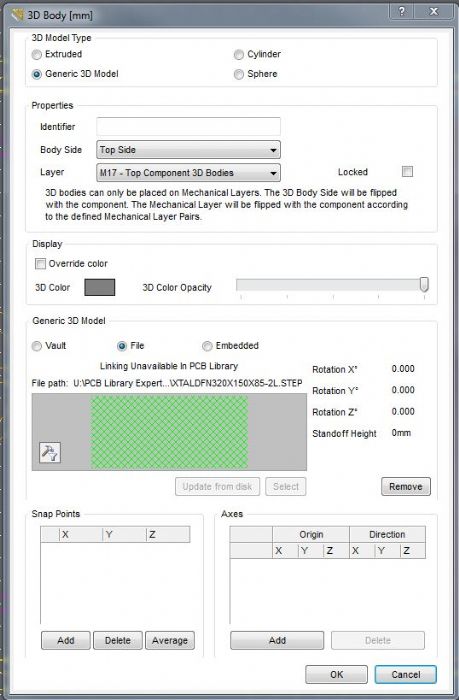

Altium has recently introduced the option to embed a footprint 3D model within the altium library.
When generating footprints this option always defaults to the linked "File" option which means you have to manually go and change the 3D model to "Embedded".
It would be nice to have the option to select embedded or linked in Library Expert.

After running the auto-import script, when you open the property window of the 3D model you will see that there is 3 options to where the 3D model is located. "Vault", "File" and "Embedded". The auto import always selects the "File" option which means that the 3D model is linked to the library rather than stored with it. Is it possible to define this option in Library Expert before generating the script file?

The ability to embed a 3D model in footprint has been around for quite a while, and it was working great with PCBLibraries.  But it appears a recent update of Altium must have changed the default setting for the location of the 3D model.  As you pointed out, you need to manually change it from "File" to "Embedded".  If you look at the script created by PCBLibraries, the following lines of code are the ones of interest:
        STEPmodel := PcbServer.PCBObjectFactory(eComponentBodyObject, eNoDimension, eCreate_Default);
        Model := STEPmodel.ModelFactory_FromFilename('C:\Component.STEP', false);
        STEPModel.Layer := eMechanical13;
        STEPmodel.Model := Model;
        NewPCBLibComp.AddPCBObject(STEPmodel);
You can observe all of the options for these objects by typing a period after the object name.  For example, type a period after "STEPModel" and you will be presented with all the parameters and methods of the object.  I played around with a few of them but wasn't successful in getting it to work.  I'll submit a support case at Altium and see if they can help identify what is needed to set the 3D model location to "Embedded".
Fortunately the workaround is simple.  But if you are batch building a bunch of components, then it would be more tedious to have to modify each component before saving the library file.

I just heard back from Altium support.  They confirmed the problem and said that it probably happened due to enhancements to the 3D Body which allow vault components to have external 3D models.  The good news is that the problem appears to be fixed in version 16.0 of the Altium software, which is due out later this year.  In the meantime we'll have to remember to click the embedded option when making components.
