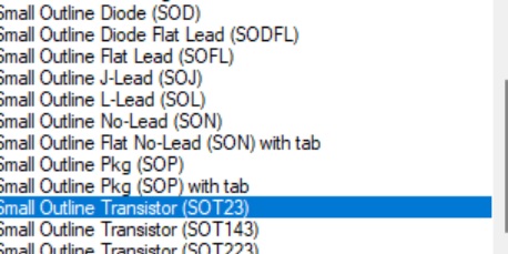

Post Options Post Options   Thanks (0) Thanks(0)   Quote m.elsayed Quote  Post ReplyReply Direct Link To This Post Posted: 2 hours 30 minutes ago at 2:12am
Please provide more details for this note "Some 3D models may not support the polarity dot"
it added for all the packages below
it will be great if have document explains this point so i can be aware by this concept

Post Options Post Options   Thanks (0) Thanks(0)   Quote m.elsayed Quote  Post ReplyReply Direct Link To This Post Posted: 2 hours 15 minutes ago at 2:27am
also
