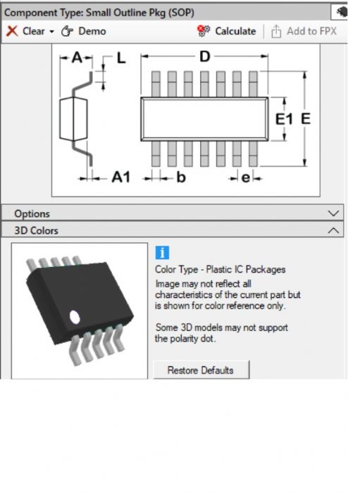

    Posted: 4 hours 11 minutes ago at 1:00pm
1-i need more detail by what means "some 3D missed dot polarity"?
2-what are the packages have this note?
3- how to correct this dot on 3D?

Post Options Post Options   Thanks (0) Thanks(0)   Quote Tom H Quote  Post ReplyReply Direct Link To This Post Posted: 3 hours 28 minutes ago at 1:43pm
This package is not a Metric Pin Pitch SOP. The Package Marking has a Dot and no chamfer on the body.
It is a 50 mil (1.27 mm) pin pitch SOIC. These packages were introduced in the early 1980's when the package had a 45 degree chamfer all along the Pin 1 edge. No Polarity Dot.
You need to know the difference between Imperial and Metric pin pitch packages.
We have no plans on changing this polarity marking concept that been around for the past 35 years.
Metric Pin Pitch SOPs come in these Pin Pitches:
  • 1.00 mm
  • 0.80 mm
  • 0.65 mm
  • 0.50 mm
  • 0.40 mm
The Imperial Pin Pitch SOIC Packages come in these Pin Pitches:
  • 0.05" (1.27 mm)
  • 0.10" (2.54 mm)

Post Options Post Options   Thanks (0) Thanks(0)   Quote m.elsayed Quote  Post ReplyReply Direct Link To This Post Posted: 1 hour 9 minutes ago at 4:02pm
Thanks Tom for your great support and help all time
just if can add more details for packages have this concept other than SOIC and SOP?
also is there any reference document i can read this point on it?

Post Options Post Options   Thanks (0) Thanks(0)   Quote Tom H Quote  Post ReplyReply Direct Link To This Post Posted: 25 minutes ago at 4:46pm
If you see a small outline package with a Chamfer along the entire side of the body where pin 1 is, than you know it's a SOIC.
If you see a small outline package with a Polarity Dot where pin 1 is, than you know it's a SOP.
  • 1.00 mm
  • 0.80 mm
  • 0.65 mm
  • 0.50 mm
  • 0.40 mm
  • 0.05" (1.27 mm)
  • 0.10" (2.54 mm)

Post Options Post Options   Thanks (0) Thanks(0)   Quote m.elsayed Quote  Post ReplyReply Direct Link To This Post Posted: 21 minutes ago at 4:50pm
great Tom,but i asking same explain for the below packages which i think it have same case, if i'm understand correct
