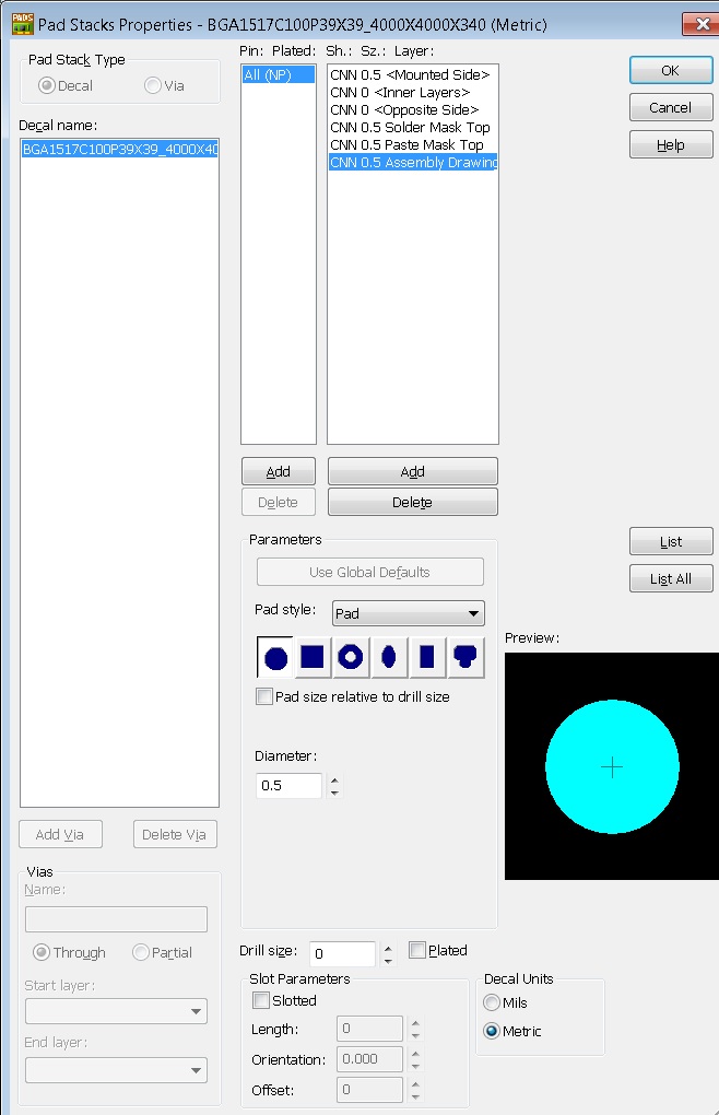

Post Options Post Options   Thanks (0) Thanks(0)   Quote AGONZ67 Quote  Post ReplyReply Direct Link To This Post Posted: 11 Jan 2016 at 10:25am
In the padstack?
uploads/71/bga_pads.jpg
Points: 6088
Post Options Post Options   Thanks (0) Thanks(0)   Quote Tom H Quote  Post ReplyReply Direct Link To This Post Posted: 11 Jan 2016 at 1:40pm
PADS Layout has the ability to put the Assembly Layers in the Pad Stack.
This is not true for every CAD tool and we needed a solution for every CAD tool.
Also, with 2D-Lines you have the option of "Outline" and "Filled" and you can't do that with a pad stack.
You have controls over which component family gets Pads on Assembly. This is because there is a Assembly Ref Des that goes inside the closed polygon and you only want both if the part is big to make room for both.
I will ask the programmers if they can add Pads to Assembly in the pad stack for PADS Layout.
