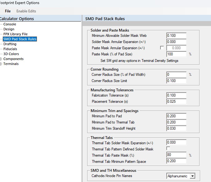

Post Options Post Options   Thanks (0) Thanks(0)   Quote m.elsayed Quote  Post ReplyReply Direct Link To This Post Posted: 5 hours 49 minutes ago at 5:14am
Thanks alot Tom for your support and great help
the purpose of question is to get understand the information from expert one like you
and know how it works and check what issue on configuration or setting i did
can find screen below for my settings , and help
Points: 5867
Post Options Post Options   Thanks (0) Thanks(0)   Quote Tom H Quote  Post ReplyReply Direct Link To This Post Posted: 3 hours 16 minutes ago at 7:47am
Footprint Expert had the default Thermal Pad Paste Mask Reduction setting at 50% for many years from 2004 - 2016. We bumped it up to 60% default after helping IPC develop the IPC-7093A standard in 2017.
For many years we set the Thermal Pad Paste Mask reduction should be between 40 - 60% with 70% being the limit to accommodate both the Thermal Pad Minimum Space (between checkerboard patterns) and the paste mask apertures.
80% paste mask reduction is too big to accommodate the Minimum Space and produce a checker board pattern. 80% - 100% will give you a single paste mask aperture that is 80% less than the thermal pad size.
You have to understand the mathematics involved in paste mask reduction and the minimum aperture spacing rule. You do the math and you'll see that everything works accordingly. Take any pad and reduce the size by 80% and see the results.
