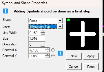

I created a Silkscreen Plus + symbol in Footprint Expert 1.00 mm X 0.15 mm line width.
Here is the Footprint Expert Symbol dialog box:

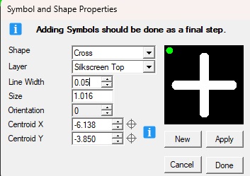

1-Silkscreen
however i have selected value line width =0.05 mm and select Apply & Done, a
and then checked found it 0.15 mm (PCb tool)

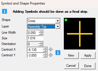

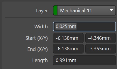

2-Assembly
however i select 0.05 mm in line width
i found it in altium as 0.025 mm
please can check and have explanation what happen and causes for this
