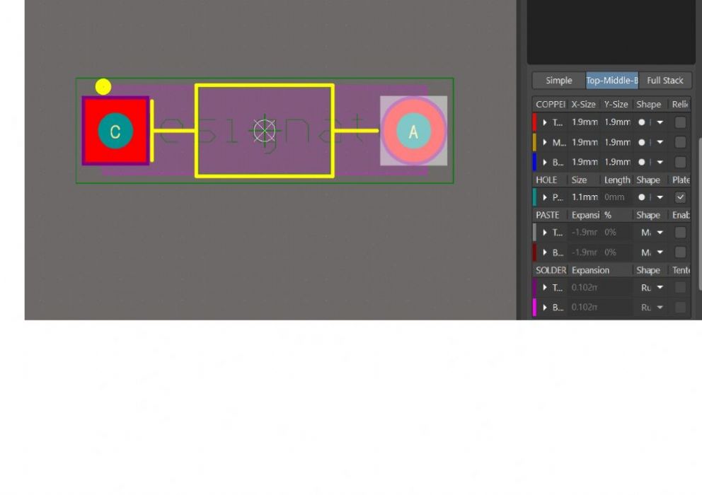

I set my Master Option settings for SMD solder and paste mask expansion to zero '0'.
I use the Altium translator I unselect 'Use Altium Mask Expansion Rules'.
When I open the footprint in Altium, the Paste Mask value is zero.
Especially through-hole footprints.
How do I solve this?

Thanks for your reply,however i have adjusted all of these but when open in altium
1-result not 0
2- pad has type not simple
