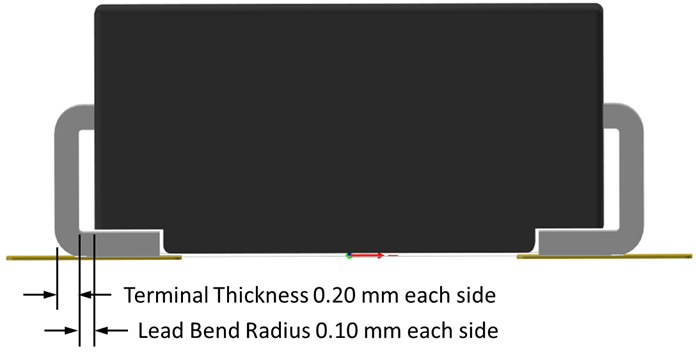

Post Options Post Options   Thanks (0) Thanks(0)   Quote Tom H Quote  Post ReplyReply Direct Link To This Post Posted: 12 Feb 2026 at 4:31pm
It is a 'Molded Body' package if the 'D1' dimension is at least 0.60 mm less than the 'D' dimension.
If the 'D1' dimension is less than 0.60 from the 'D' dimension, then it's an FP Designer footprint.

Post Options Post Options   Thanks (0) Thanks(0)   Quote Tom H Quote  Post ReplyReply Direct Link To This Post Posted: 15 Feb 2026 at 11:45am
If D1 is less than 0.60 then start in the Molded Body calculator with most of the dimensions and the mfr. recommended pattern.
Then move the footprint to FP Designer and fill out the 'Specifications' panel and edit the Body dimensions and pad stacks as needed.
