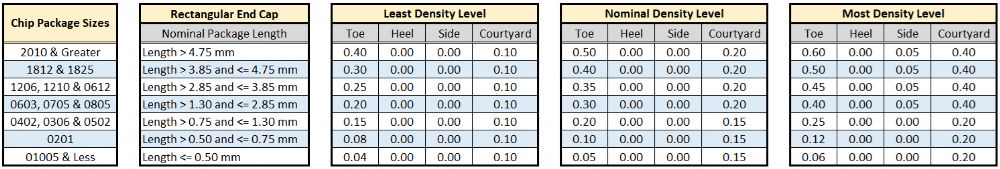

The unreleased IPC-7351C had new solder joint goal tables for Gull Wing and Rectangular or Square End Cap packages.
The Square End Cap solder joint goals need to have unique Toe values for every chip size.

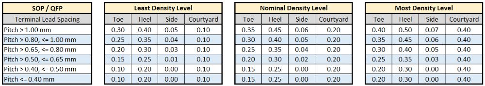

The Gullwing terminal lead needs a different toe goal for every pin pitch.
SOP/QFP Table:
