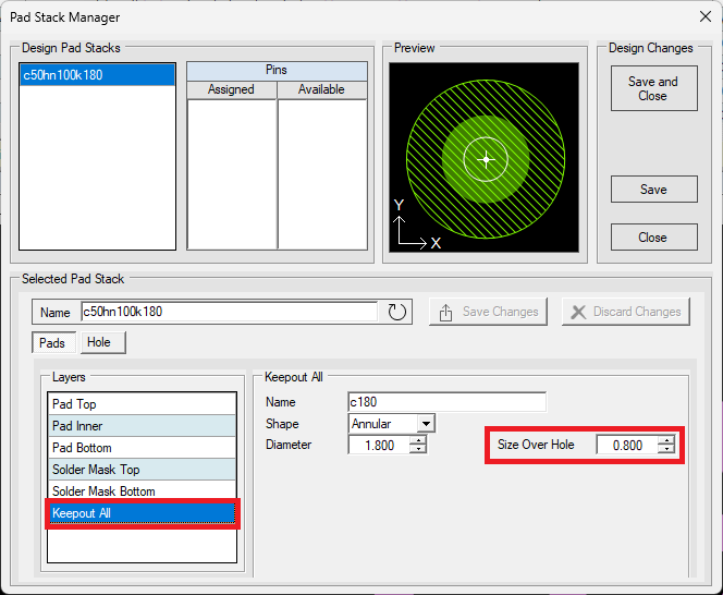

Add a minimum annular ring for keep-out for non-plated holes in 'Tools > Options > Terminals > Through-hole'.
The current method of making the non-plated hole keep-out the same size as the Anti-pad does not work it you need a keep-out clearance larger or smaller than the Anti-pad.

You can edit the pad stack keep-out in the Pad Stack Manager.

2- from shown screen how i control min annular ring, for example if want make it 0.635

Making the non-plated keep-out size smaller than the plane anti-pad is not good PCB design practice.
Your signal traces need a clean return path on the GND plane.
We like to prevent traces from running over a Plane Anti-pad.
Your request for this feature was declined based on good PCB design principles and guidelines.
